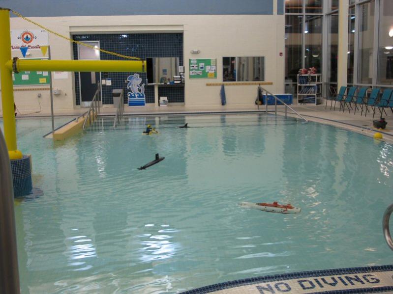

      Here's some more pictures from the run.

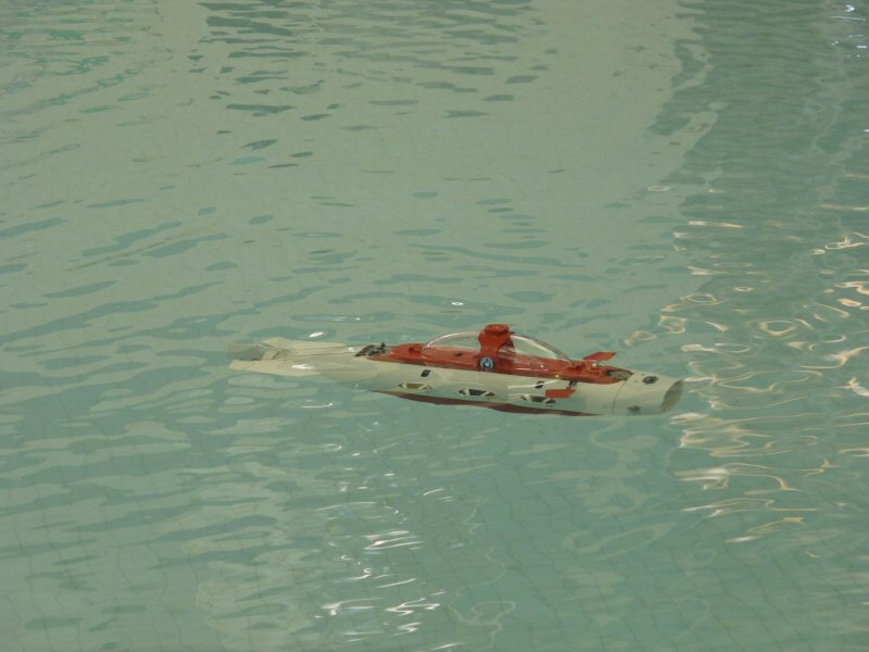

              The pictures have a flying sub in the water! Is it one of the new builds? You guys have me thinking about making one with all the activity on the thread after the kit was re-released. Now the thread is quiet. Are the builds still progressing? Are the control challenges being worked out?

                  Hi Bob,
                  That is indeed my partly completed build of an original issue FS-1 kit that I've had laying around for far too long. Last month and this were my first two test runs, both unfortunately cut short by a faulty seal that refuses to stay glued to the aft end cap. What I learned from these short runs is that the FS-1 wants to dive if ballested level, even with just a little forward way on. Deflecting the jet thrust upward a bit wouldn't overcome this tendency. Adding an ounce of weight so she floats somewhat nose up made a big difference though, and she ran quite level. Now I need to play with adjusting the foam so she sits level on the surface too. As BD said, still dialing her in.
